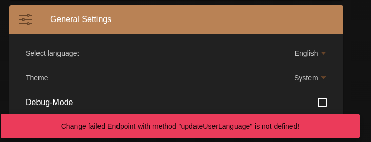

I’m facing a problem, I can’t set the UI in English or other languages different from the default (de)
I’m logged in with the admin user, when I try to change the language I’ve the error see the attached image
Could you help me ?

Same here. But did you notice this remark?
The language can not be changed permanently in the local online-monitoring for technical reasons.
Maybe this only works on the backend?
yes. exactly this is the case.
So we have to configure the backend (in my case the edge) by modifying the openems edge code ?
Are there any guide about changing openems language ?
The Backend and the Edge are two different software packages. In my understanding you would need to install the Backend in addition to the Edge.
Maybe this is what you are looking for:
How about adding this requirement to the error message? Suggestion: “Change failed Endpoint with method “updateUserLanguage” is not defined! Please ensure, that the Backend is installed and configured correctly.”

The reason why this is not possible with Edge is, that currently there is no handling for UpdateUserLanguageRequest in Edge. It’s not currently on our roadmap to implement this, but it would not be too hard to do it… The value should maybe be stored in the UserService configuration: openems/io.openems.edge.core/src/io/openems/edge/core/user/Config.java at develop · OpenEMS/openems · GitHub
