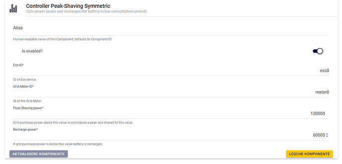

we have an energy storage system and I want to use the Controller Peak-Shaving Symmetric to reduce the peaks in our energy consumption. I configured the controller but the battery is never loaded and therefore also the peaks are not reduced.
Here is configuration of the controller:
Do I need to configure anything else to make it work?
Kind regards.
Hi @rene ,
this specific configuration looks correct; but of course the problem can be somewhere else.
Which Energy Storage System are you using?
