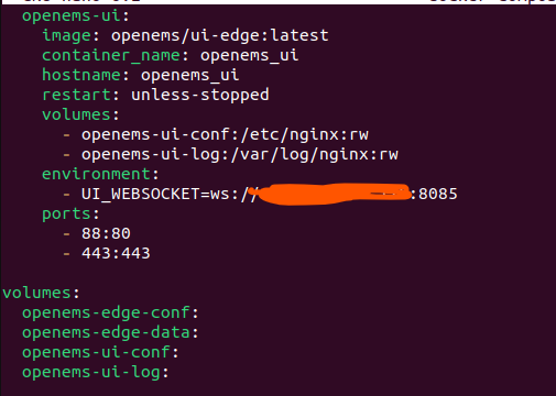

I’m trying to run OpenEMS using Docker on Ubuntu. Both containers start successfully:
The Edge container works fine — I can access Apache on port 8080 and see logs from the Edge container. However, the UI does not connect. When I open the browser and go to http://localhost (or port 80), the page does not load.
Here’s the relevant part of my docker-compose.yml:
I tried changing ports (e.g., 88:80) and restarting Docker, but the UI still doesn’t show up.
Has anyone experienced this? Why does Edge start and run normally but the UI container cannot be accessed through the browser?
Any help or suggestions would be appreciated!

UI_WEBSOCKET was recently replaced by
      - WEBSOCKET_HOST=openems_edge
      - WEBSOCKET_PORT=8085
HTH
