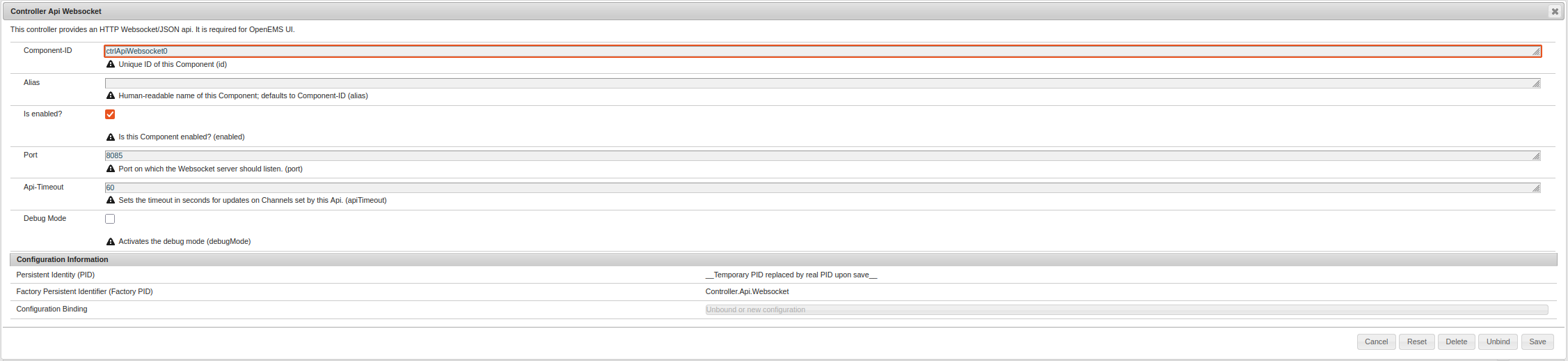

I’m puzzled especially about the last line. Additional info, Felix shows:
@da-Kai Do you have an idea what I missed? :slight_smile:
