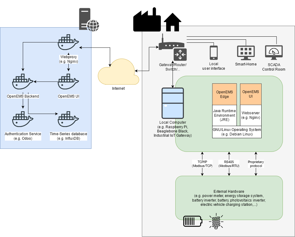

one fundamental question from my side. Why do you want to have Edge and Backend on your Raspi?
As you can see in this picture, you only need the edge and ui running on a local computer.
alright thanks for sharing this , its clear now, I thought i need both edge and backend to be running on my rpi. ok now how about the Ui config setting on my rpi ? I have basically copied the whole ui directory to me pi and after installing nodejs and npm etc , I ran ng serve from the terminal in which I was able to see the openems Ui on a local host but is this the correct way which I dont think it is after seeing the picture above. Can you guide me on how to set a webproxy for eg nginx and which files do I need to copy from the ui directory on my windows machine. I think I have just implemented this the wrong way.
you are close to run the ui! No need to run ng on the raspi, this will do nginx/apache.

thanks, it works perfectly also can you tell what is to be done with the ui folder created in the dire ui/target/backend . where does this www-data for backend needs to be in and also to integrate now the ui , edge and backend as mentioned in the guide , how will it all work? as seen from the pic above , the backend is shown along with the Ui in the left blue box of the image. how can one setup such an implementation as I am now running the ui and edge on my raspi but I am unclear on the otherside . for A real time application the backend and edge should both be running and integrated with the ui right ? again thank you for your easy-to-understand steps
Hello Bilal,
the main thing is:
Do you really need a backend? You can have complete control over one system (household) although with time-series database. What do you want to do with the backend?
