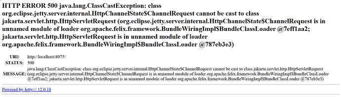

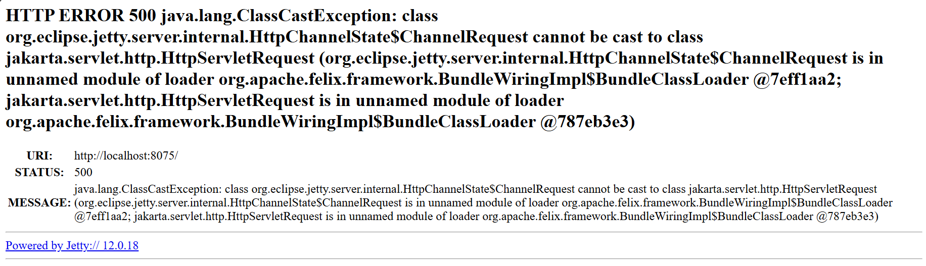

When trying to send a JSON-RPC request to the OpenEMS Backend, I get a ClassCastException. This happens not only when trying to make the request but also when opening any URL under localhost:8075, as can be seen here:
After running the Backend, I simply created a Backend2Backend.Rest component, which uses the port 8075 by default, and tried to send a Postman request. This issue occurred while running the latest Backend Docker image, but I also attempted to run the backend through the source code in Eclipse, and got the same Exception, shown below.
