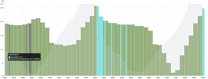

@yvesilknievil, @as_py: I’ve been playing with implementing this feature in Energy Scheduler v2 recently and it looks promising:
The code is already on develop branch. You just have to configure
As discussed in networking friday, you can of course also simulate it via the RunOptimizerApp.
I am very interested in hearing your feedback!

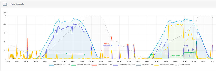

Dear Stefan,

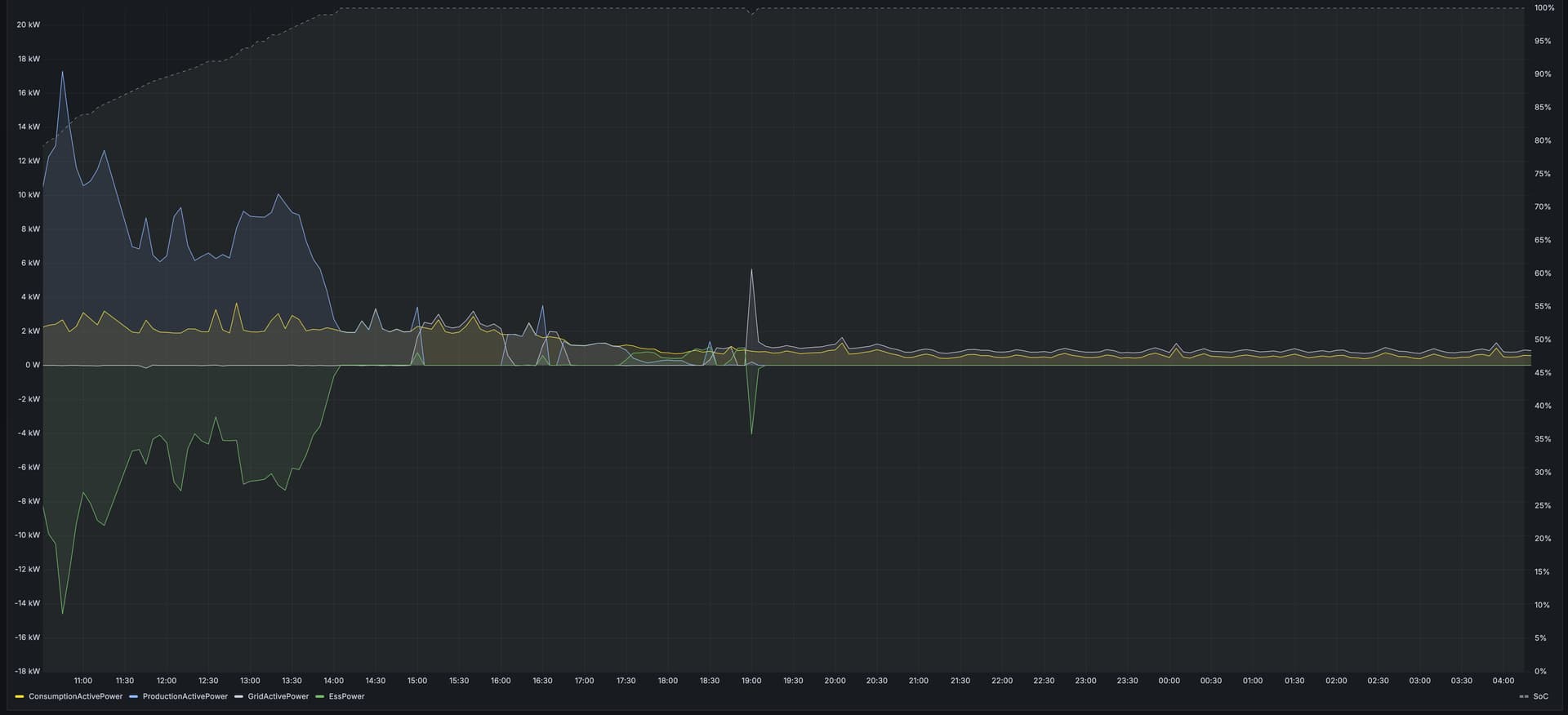

we implemented the new controller and Tuesday evening and unfortunately, it didn’t work so far. I did not have time to look into it in detail, will do that beginning of next week, but i still thought it might be nice to share it with you, in case you immediately spot the problem. It is a Sigenergy system with 30kWp and 96kWh.
(ignore the missing data in the second plot from 11-12, this is just a dashboard issue)
As you can see, it never fed in, even when the ToU controller said so: At 14:00, 100% SoC was reached and it actually reduced the production, even though the price would have been high enough to feed in.
Then, it gets even weirder: Whenever DISCHARGE_GRID is active, it completely disables the production and takes all power from the grid, not from the battery. From 18:45-19:00 BALANCING was active, at 19:00 DISCHARGE_GRID started again and actually used energy from grid to charge from 99% to 100%, which was completely unnecessary at this point.
Do you have any ideas what could cause this? As said before, I will have time to take a closer look at the beginning of next week.
Best and thanks again,
Alex

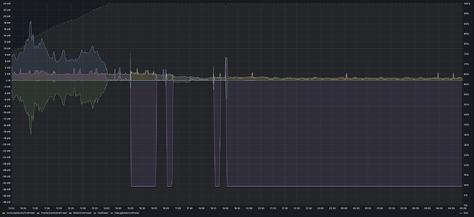

@as_py: Thanks for the experience report! I don’t know the Sigenergy implementation - is it open source somewhere?

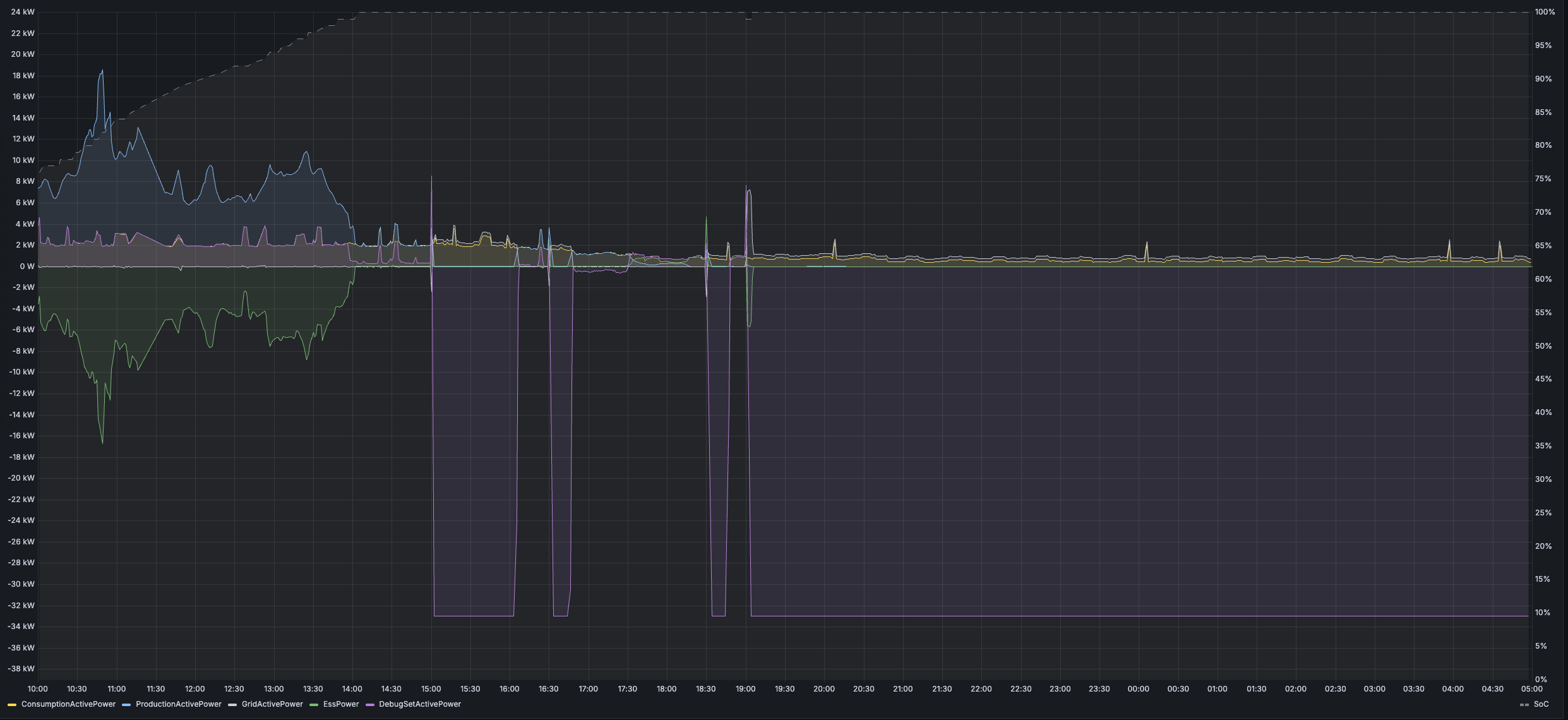

It would be interesting if a discharge command (i.e. a positive set-point value) was sent to the ESS at all. Can you please plot the Channel ess0/DebugSetActivePower?
Hello Stefan,
thanks again for your reply! Unfortunately, the Sigenergy implementation is not publicly available at the moment, as it is still in development and apparently also not working correctly. I also didn’t implement it myself, but I will talk to the developer about a release.
As desired, I added the channel ess0/DebugSetActivePower to the plot:
So a discharge command was definitely sent to the ESS, but never executed.
Best,
Alex
Ok, then it’s as expected: DISCHARGE_TO_GRID was working, but the ESS implementation did not actually apply the set-point properly. I cannot help much without seeing the code then, sorry. Maybe consider switching to a well-supported FENECON system then… :wink:
