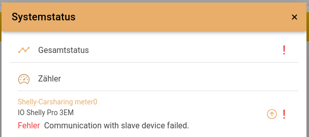

I’m trying to setup OpenEMS Edge & UI (both docker) and added a first component: Energy Meter Shelly Pro 3EM. In the UI I now receive an error “Communication with slave device failed” as system status (cf. below screenshot). The live system log in the UI does not show any error message.

Screenshot of UI system status dialog, showing the error message:
Seems like a Basic Docker Issue, where your Docker Container is not allowed to Connect “Outside” of itself maybe?!
Also check if your Shelly has a Password on the UI - not supported.
Thx! That was the cause. Do you know if this is a limitation of the API or if the feature is “just” not implemented?
