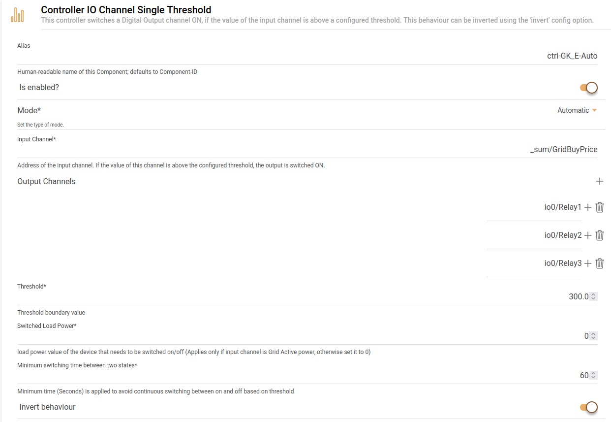

The controller is configured as depicted in the screenshot:
But the controller seems not to work, the debug log shows:

The problem is not the entered threshold value, but the type of the input channel.
_sum/GridBuyPrice is of type DoubleReadChannel
but the input channel of a ControllerIoChannelSingleThreshold has to be of type IntegerReadChannel:
IntegerReadChannel inputChannel = this.componentManager.getChannel(inputChannelAddress);
Maybe the variable inputChannel should be changed to DoubleReadChannel and there should be a handler that determines the input channel type and converts the value to Double.
