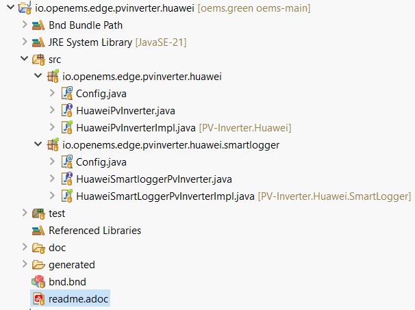

Hi @piM,
there is no need to implement the device. We already have an implementation for the Huawei 2000 and the Huawei 2000 accessed via Smartlogger:
Just need to clean it up and do a PR. Should be possible until Wednesday.
@c.lehne: Great. One early note: please change the namespace to io.openems.edge.huawei, because there is going to be much more than just PV-Inverters.
Hello everyone, Hi @piM,
We created the PR feel free to edit / improve
Important note (as mentioned in the PR)
We started to implement the Huawei PV Inverter, after the skeleton/implementation of registers/component was done, the system we originally planned to use this, switched to the SmartLogger.
Therefor the PV Inverter is not tested but the SmartLogger is.
