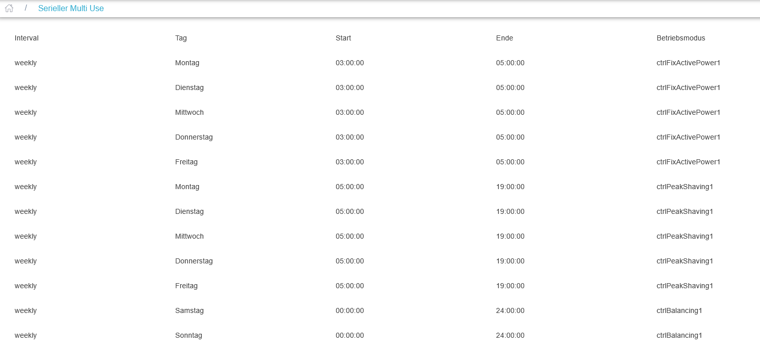

There is already a graphical calendar in the UI history, to select a custom date range. IMHO it would be good, if the different calendars look (and behave) the same, to offer consistency to the user.
I don’t know much about the context of (the JS-Calender) scheduler usage. I believe it could be helpful to spend some time understanding the tasks and context (and maybe also user), to derive requirements which should guide the graphical design.
For example, I could imagine that setting up the scheduler component (task) would happen on a computer with a keyboard (context) by someone who is used to administer systems (user). If this is true, a keyboard based text-input possibility in addition to a graphical calendar UI could be helpful.

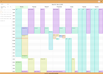

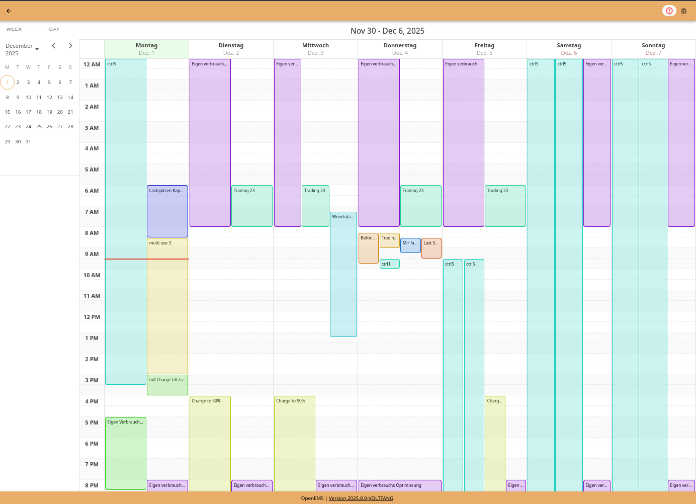

Hey, I already started implementing the Calendar in the UI now. Our UI Designer is ill so im flying blind for the time being and am just trying things out. But here is my current state of things:
Ive decided on using angular-calendar as i feel like it provides the best balance of customization and features.
Ive implemented a Scheduler-Specific JSCalendar “engine” which provides the calendar with the correct events for a given time range, but this engine can be made more generic to support any JSCalendar in the future (payloads). This engine handles recurring events and acts as a translation layer between the JSCalendar data format and the angular-calendar data format. It also supports moving/resizing events and updates recurrence rules accordingly.
To give the user a sense of which events are connected and which aren’t, i am giving each event a name (and all of its recurrence “children”), and based on that name im generating a random but deterministic color. That way the edge doesn’t need to store colors and the calendar will look the same on every device. :smiley:

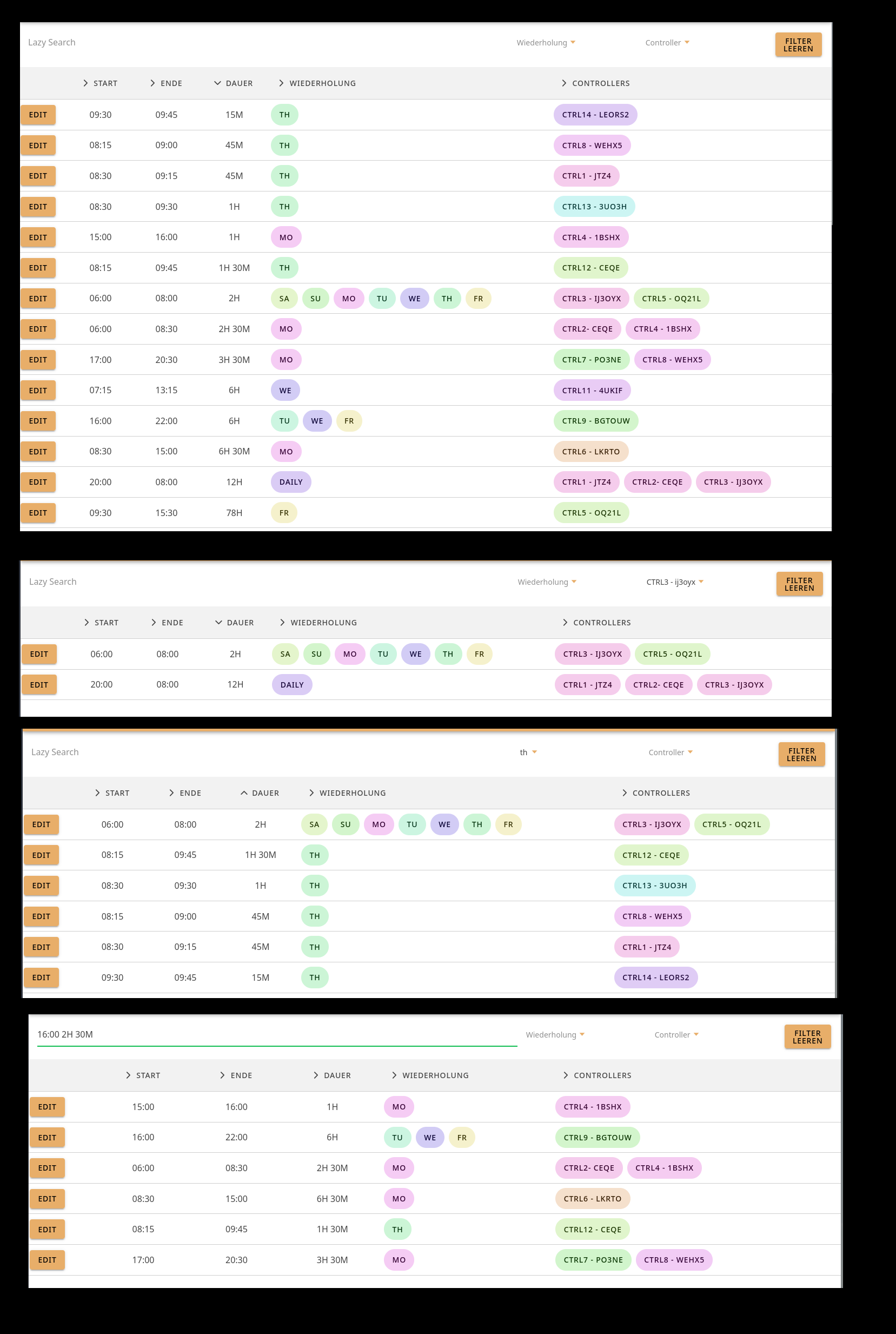

Update time :smiley:
I now have this list, it allows for sorting all values. It also supports filtering for Recurrence Rules and Controllers. As well as Fuzzy Search for all Values.
(Editing/Creating/Deleting doesn’t work yet)
The Design is far from done :slight_smile:
Internally the List creates a new entry for Each Recurrence Rule, and then merges all matching entries before saving.
(So like “Daily CTRL7” will be merged with “Weekly CTRL7“ into “Weekly/Daily CTRL7”)
This way every entry in the list only has one rule to worry about, I think this is a good way to not make the UI super cluttered with list of list of list of rules.

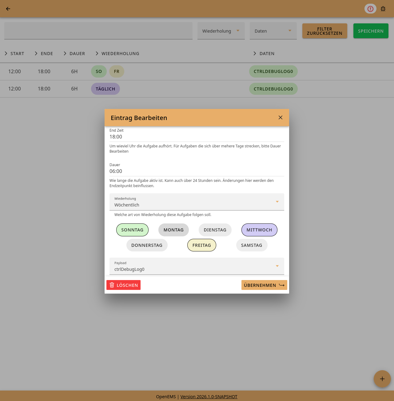

Hello again,
I now have a MVP! The list allows for modifying, deleting and creating, saving, discarding and loading :smiley: Translations are also added already.
Basically looks the same as the pictures from a week ago, except the edit modal which looks like this:
(Just to reiterate, the design isnt finished, but feedback is still welcome :D)

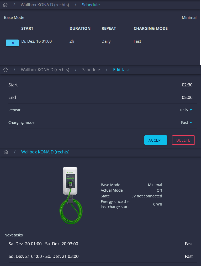

Hello everyone,
we at Fenecon have been working hard over the past few weeks to integrate manual time-based charging of EVs into the energy schedule. We also used JsCalendar Tasks for this. These changes are already available due the backport (2025-12-17).
Functionally, our implementation is already quite advanced. In terms of UI, we have focused more on making sure it works, and we are aiming for significant improvements at the beginning of next year.
Here is some information about our current status:
Basically, this is only available for the new EVSE architecture, which replaces the previous EVCS architecture. It is also only available in the new UI navigation. There is a ‘Schedule’ chip in the navigation. There we also have a tabular overview of the tasks, similar to the one @Floschy implemented. Although I have to admit that yours looks much better, good job!
You can then add tasks via a chip in the navigation. Currently, this is still limited to start and end times. The only recurrence rule currently available is ‘Daily‘, and you can select a charging mode. The edit page looks similar to the create page.
The next tasks are then displayed on the main page.
To add, edit, delete, and retrieve tasks, corresponding jsonrpc requests were also created on the Edge.
