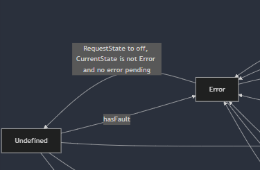

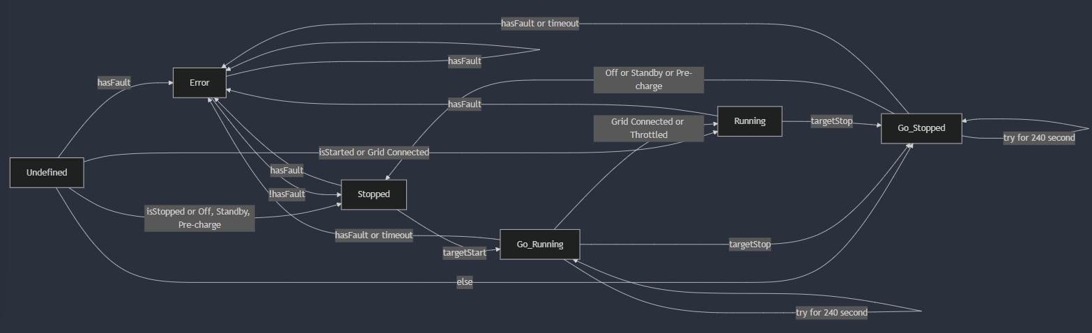

Yes, we are not acknowledging the error in the Error state of the KACO because we want to remain in that state to analyze the cause of the error. We are following this state machine inside the Openems.
Additionally, we did not capture this “No pending state” state either, and it is probably that the service manually restarted the inverter.
And it makes sense to incorporate logic to acknowledge the error and transition from the "Error " openems state to an "Undefined " openems state after setting the RequestedState to “OFF” and only if the CurrentState is neither “Error (7)” nor “No error pending (12).”
And avoid manually restarting the inverter.
thanks,
Pooran
