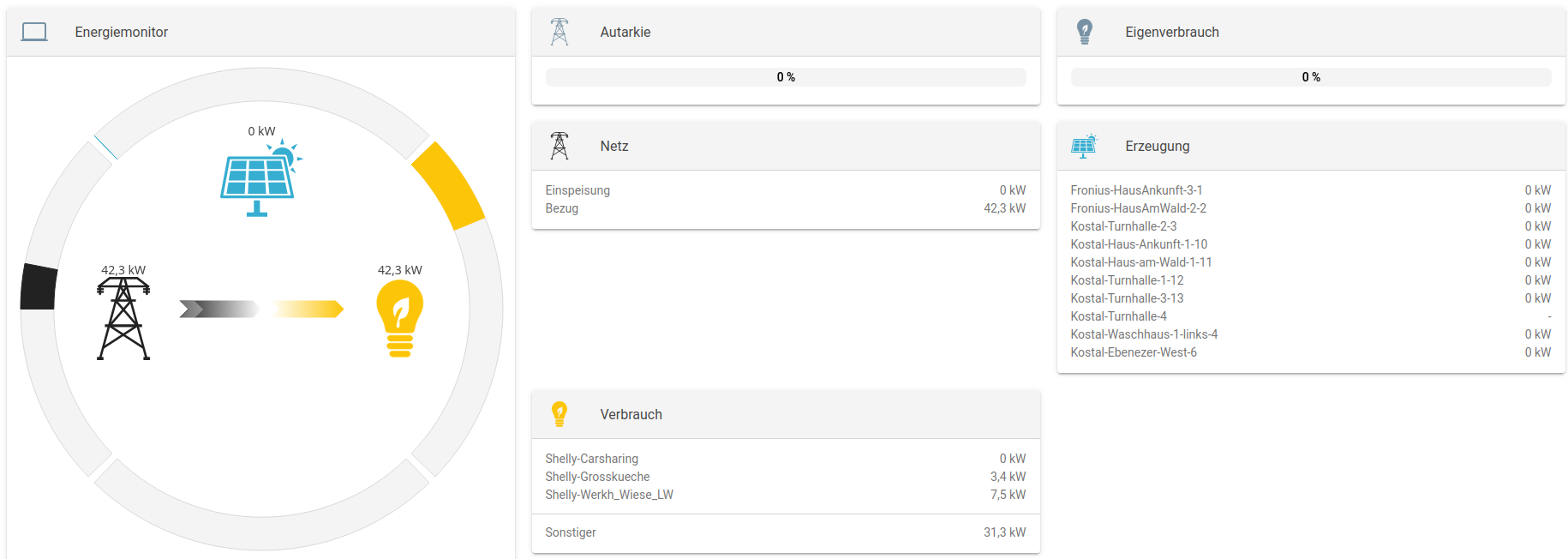

I’m adding all pv inverters in our system. Until the 10th inverter, everything looks good:

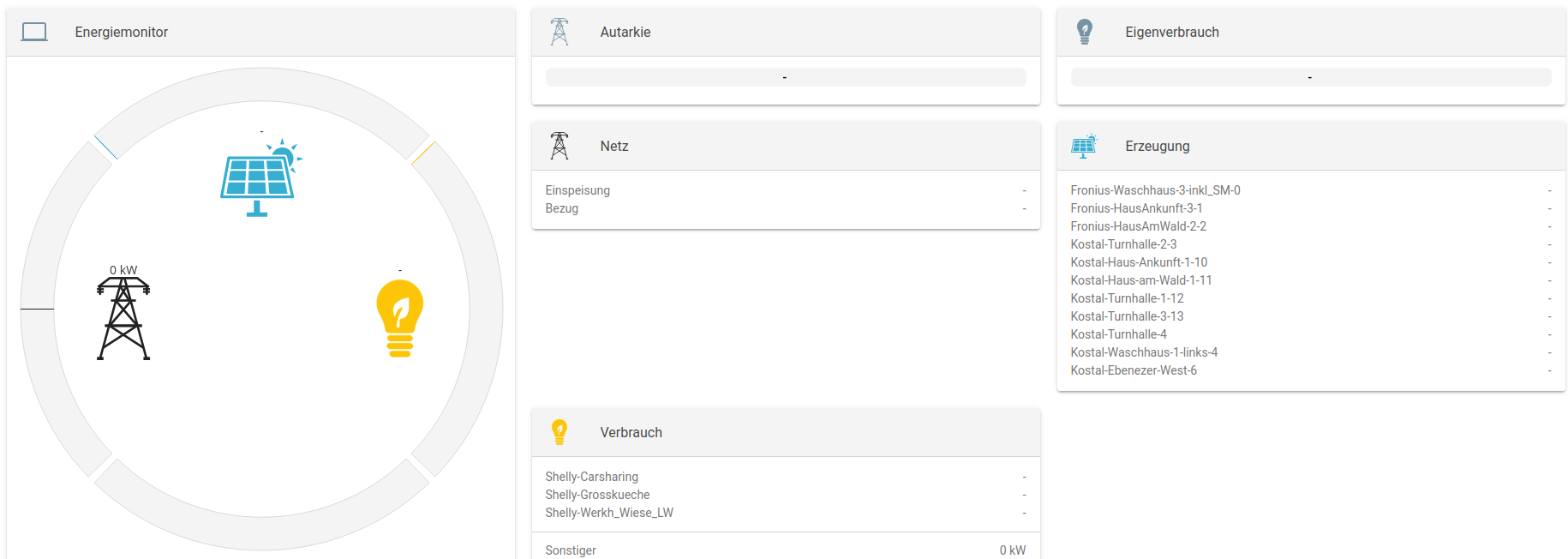

But once I add the 11st pv inverter, the system somehow fails and no values are shown anymore in the UI:
The system log in the UI doesn’t show anything. Can anyone tell me what’s going on?
Well basically i guess you are using our “new” Kostal Piko Html parser right?
If yes, i guess you are running into a “fetching” issue and timings of 1second per Cycle is too much for fetching a few MB per second.
Greetings
yes.
But the limit seems independ from the inverter type. E.g., I use eight kostal html parser inverters and two modbus inverters. The system works. I now add an 11st inverter, and it breaks. This happens in any case, independently if the 11st inverter is a kostal htmlp parser type or a modbus type.
Thus it doesn’t look to me like a timing issue.
Set your cycle time to 5 seconds and test
no change, also setting it to 10s didn’t change anything.
Technically there is no limits on the number of PV inverters. We run a system with 30+ pv inverters without any problems. Your inverter “Turnhalle 4” already indicates a problem as it doesn’t show a value. This may lead to subsequent faults. Without logs, it is hard to say what your problem is.
