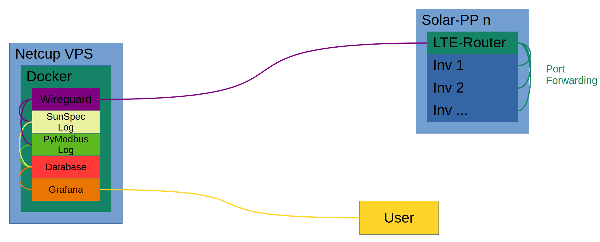

I’m part of an energy cooperative with a growing number of distributed solar systems.
My goal is to have a self-hosted monitoring solution where the inverters only access to the internet should be the monitoring VPN with minimal hardware (at least at first).
When doing my initial research, I didn’t find a solution that met my requirements (must’ve overlooked OpenEMS). So I wrote two small logging scripts of my own, one for SunSpec Modbus TCP compliant devices and one that adapts non-SunSpec Modbus to the SunSpec data models. Both write data into one database, the database tables basically represent different SunSpec models.
Here is a basic sketch:

  1. At this time and also for power plants that don’t need anything apart from monitoring, I’d like to forego additional hardware on location and keep it simple with just the LTE-Router. As far as I can tell, this is not really an intended use for OpenEMS? As a workaround, I could run one or more (?) Edge Dockers on my VPS, right?
  2. If I understand the documentation correctly, I need to manually define Modbus Tasks if they are non-SunSpec devices? For SunSpec there is already a general implementation? Are there already some configs for common non-SunSpec inverters from Sungrow, Goodwe …?
  3. In the future we’re interested in controlling batteries, evcs, … Would there be a way to use the OpenEMS control algorithms with data from a non-OpenEMS Database? Then I could start off with a basic and easy to overlook solution for basic monitoring to quickly get up and running. And then take my time later on to understand OpenEMS which seems like a big project (and get back into java).
