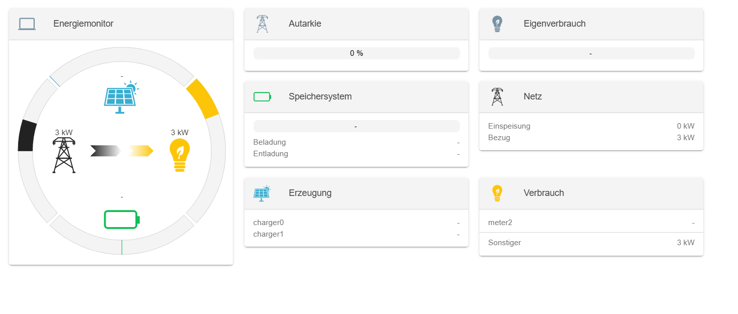

I’m currently running OpenEMS Edge + UI via Docker, and everything is working fine.
I want to write to specific Modbus registers (e.g., ess0/SetActivePowerEquals) directly from:
  • Apache Felix Web Console → Configuration, or
  • OpenEMS UI → Components / Controller,
However, from the current UI and Apache Felix configuration interface, it seems there is no direct way to perform the write action, even though the controller Controller.Api.ModbusTcp.ReadWrite is configured and running.
Is it possible (using the docker edge&UI ) to:
  1. Write or override a channel value (like SetActivePowerEquals) via the OpenEMS UI or Apache Felix console,
  2. And have that value actually sent over Modbus/TCP to the target device?
If yes, what’s the correct way or example setup to achieve that?
