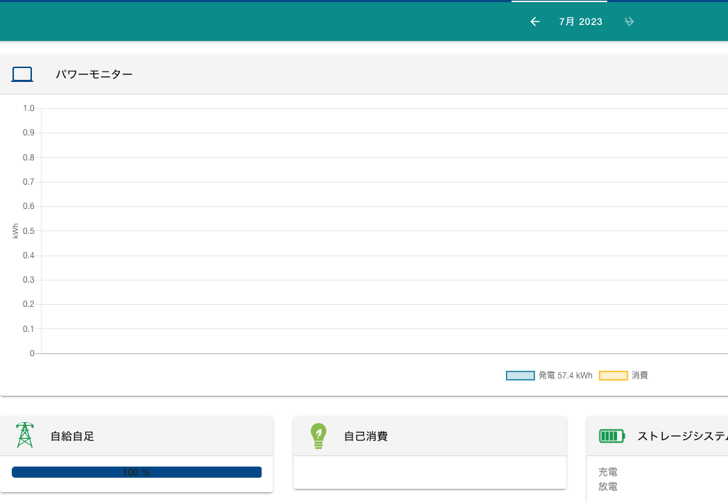

Hi there, I have a problem when I want to only left the bar chart for _sum/ConsumptionActiveEnergy, sometimes I choose the days or months unit, the _sum/ConsumptionActiveEnergy response shows null and sometimes shows the number, I want to know how to solve this problem?
Hi, to be able to help you, i need more information. Is your problem just a displaying problem? For which periods is the response null and for which not?
Hi there, there is two problem base on the current code repo.
1st, the bar chart doesn’t show up like line chart in the month period chosen like snap
2nd, when I choose the week period in the history page, the web page will be crushed like routers and header tag changes will be mixed, I snap the console error message, but the energy chart will show up, please help me

Thank you lukasrgr, I indeed implemented a new language but my problem is bar chart doesn’t show up in the history monitor quickly and after a while, it shows up the month data like July is wrong from every day _sum/ConsumptionActiveEnergy on this channel.
In fact I add a weekly code below to fix the snap crushed problem when choosing week period time . But in the end, I still need help showing the bar chart when I choose week or month period.
