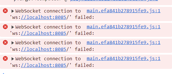

When I connect to the website, I only see an empty screen with header - no login
This is what I get as log from the webbrowser:
Do you have an idea what went wrong here? :slight_smile:

Hi dear @mario1991
some times Port 8085 is used with another programs.
Did you try to use another ports or check that be free for opening in your Raspberry?
and please check all part of OpenEMS be running.
Check all “Getting Started” guide steps once again it will be very helpful.
