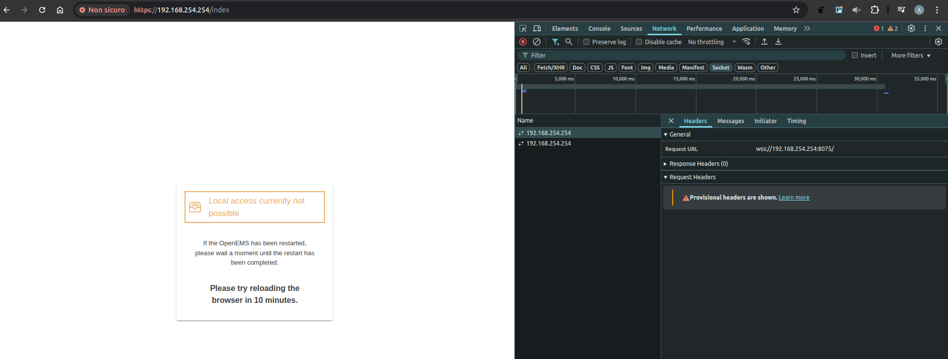

If I use https, I’ve got problem related to the web-socket connection it seem that the edge does not respond to the web-socket request. (se picture)

Hi Alessandro,
TLS encryption required by HTTPS requires additional configuration of the WebSocket library.
It is possible, but would require additional configuration properties like Keystore, etc., as can be seen in this example: Java-WebSocket/src/main/example/SSLServerExample.java at master · TooTallNate/Java-WebSocket · GitHub
If you go that way, I’ll welcome your Pull Request.
I would personally argue that this function is best implemented outside of OpenEMS in a separate proxy service, like NGINX.
