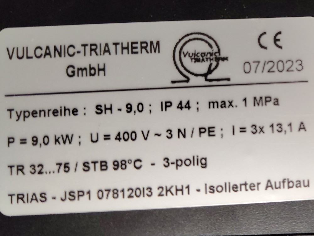

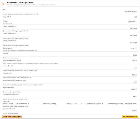

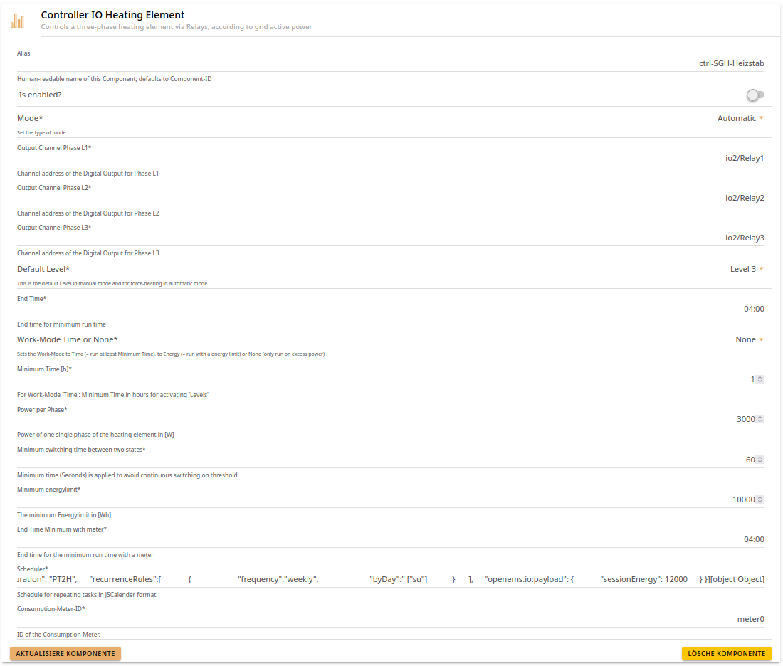

A device (a heating element) should be powered up for a given time frame[1] once a week. Which controller would be best suited for this usecase? I had a look at the Controller IO Heating Element but it seems a bit over-complicated for our use case. Is there a better suited controller? Additionally, I’m not sure how to provide the date parameter in JSCalender format to the Controller IO Heating Element. I found following example in ControllerHeatingElementImplTest9.java:
"@type":"Task",
"start":"08:00:00",
"duration": "PT12H",
"recurrenceRules":[
"frequency":"daily"
"openems.io:payload": {
"sessionEnergy": 12000
But to be honest, I’m not sure how to translate that to the input field in the controller set-up screen of the UI. Would { "frequency":"weekly" } be enough for the Scheduler input field?
