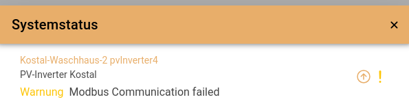

We’re running some old Kostal Piko 4.2, 5.5, 8.3, 10.1 PV inverters, which I like to connect to OpenEMS. Using the PV-Inverter Kostal component I receive a Modbus Communication failed warning message and no values are shown in the UI. I unfortunately do not find any Modbus settings in the web UI of the Kostal pv inverters.

Screenshot of warning message in OpenEMS UI:

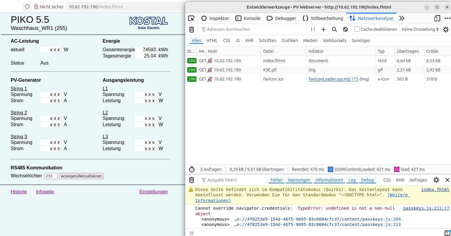

Under developer tools → network analysis I only see:
<wr-ip>/index.fhtml, one gif and favicon.

Ok, if you inspect the page where the inverter shows it‘s values using the developer tools F12? Make sure you have the page displaying inverter details (pv production, …).
There the endpoints should be shown?

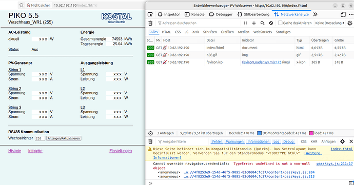

If I get you right, only the three files mentioned above are shown. Screenshot:
So, I believe we need to go for downloading index.fhtml and extraction of the desired values then. But there is nothing ready and needs development?!
Please refresh the Page, after Opening the Tools, as otherwise the Data is not Displayed.
