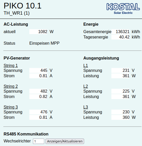

What do you think? If there is no update and modbus registers are not known - should we try to inspect the html? If you agree and provide a static html (just download the power value overview) it should be possible to help implementing a component only providing values as PV inverter implementation.

Thus we are back to the question to either scrap the web interface as @iseeberg79 suggested or attach smart meters (e.g. Shelly Pro 3 EM) as @Sn0w3y suggested. We are talking about 5 buildings with 1 to 3 inverters each (11 inverters in total). These inverters will not receive any updates (to their web UI) anymore, as Kostal does not provide any. Looking at the web UI probably the status field is the only one not possible to get via a smart meter. Is one or the other way more recommended (also thinking of integrating it into OpenEMS)?

Andernfalls wird die Implementierung ins OpenEMS schwer bis unmöglich - hat diese Status Seite eine Authentifizierung? Wenn nein, dann wird es wieder etwas “leichter” - kannst du mir da mal VPN geben, dass ich sehe, wie das ankommt?
“Standard”-Kommunikation via Modbus/RTU wäre auf jeden Fall zu bevorzugen.
Falls es nur per Web-Scraping geht: “jsoup: Java HTML Parser” ist schon als Abhängigkeit in OpenEMS: https://jsoup.org/

Ja. HTTP Auth.
Hab dir eine Nachricht geschickt.
Thanks to the huge support of @Sn0w3y the current insight is that parsing HTML seems more feasible than Modbus support. Generously @Sn0w3y did an implementation and prepared a PR:
