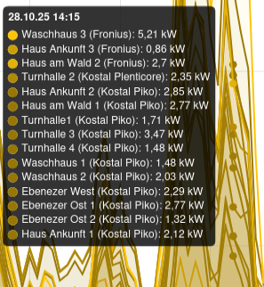

@Sn0w3y I just recognized another thing which puzzles me, maybe you have an idea about it:
Looking at todays history, there are no values for the Kostal Piko inverters:
This seems to be wrong, and displaying the graph of the inverters, I do see values (as well, as the live view showed values):

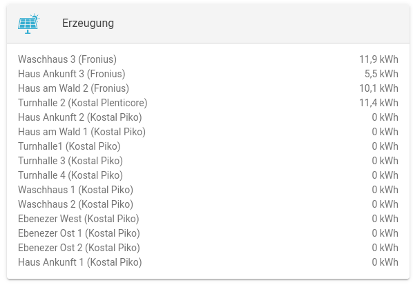

It worked with RRD4j on my system (History showed values for the Kostal Piko pvInverters in the Production widget), but now it does not anymore… Same situation as with InfluxDB.

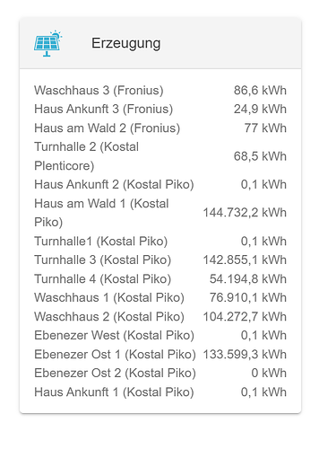

First of all, the values are back with the RRD4j, as you can see on the screenshot below. I do not know why, nor what I changed to make that happen..
Fixing the conversion bug in the HTML-parser (missing kWh→Wh) of the Kostal Piko (see fixed Kostal Piko HTML parsing bug: kWh for Total Energy in HTML, instead of expected Wh in ActiveProductionEnergy by janklostermann · Pull Request #3465 · OpenEMS/openems · GitHub ) I got a weird effect:
For all the Kostal Piko pvinverters I suddenly got huge numbers in the History, as you can still see on the screenshot for e.g. Turnhalle3. As if representing directly the values from channel ActiveProductionEnergy as shown above, but without conversion from Wh to kWh.
The screenshot below I made after I did the following after this discovery:
  1. Reverting the above mentioned PR with the bugfix, compiling again, restarting Edge.
  2. Deleting the RRD4j from the config through the UI. After that history was not available anymore, as expected
  3. Reinstalling RRD4j though the UI and switching back to history
  4. In the first moment all Kostal Pikos had still these huge values, but then new data apparently arrived and some were updated, like Turnhalle1, to far smaller values. That’s the moment, when I made the screenshot.
  5. After a while, all Kostal Piko were then down to 0 or 0,1 kWh
What I do not get: Why does removing a factor of 1000 result in a display change of factor 1000000? What is there happening in between? And where in the code is this done?
After putting the bugfix from the PR back in, the huge numbers where back again.
Yes, thats expected. You read the WHOLE value for that day - so you see it on the first day, where it has been read.
The next day it should work again i guess.
Energy values in OpenEMS per definition have to be steadily increasing. The history then just shows the last value minus the first value of a Period. You need to let it run for an entire day without changing the factor to get proper values.

Your assumptions all seem to be right. I did not follow the details of the Kostal Piko implementation, but in the latest PR ( fixed Kostal Piko HTML parsing bug: kWh for Total Energy in HTML, instead of expected Wh in ActiveProductionEnergy by janklostermann · Pull Request #3465 · OpenEMS/openems · GitHub ) the conversion for energy values (totalYield → stored as ActiveProductionEnergy in OpenEMS) was fixed to multiply with 1000.
This means for systems that had been running before, the the update there are very small values written in ActiveProductionEnergy; and with the update they are much higher. Example
  • 05.12. 00:00 ActiveProductionEnergy = 10
  • 06.12. 00:00 ActiveProductionEnergy = 11 (day of update)
  • 07.12. 00:00 ActiveProductionEnergy = 12,000
  • 08.12. 00:00 ActiveProductionEnergy = 13,000
Daily Production Energy will be correct for 07.12. (13000 - 12000 = 1000 Wh); but wrong for 06.12. (12000 - 11 = 11089 Wh)
